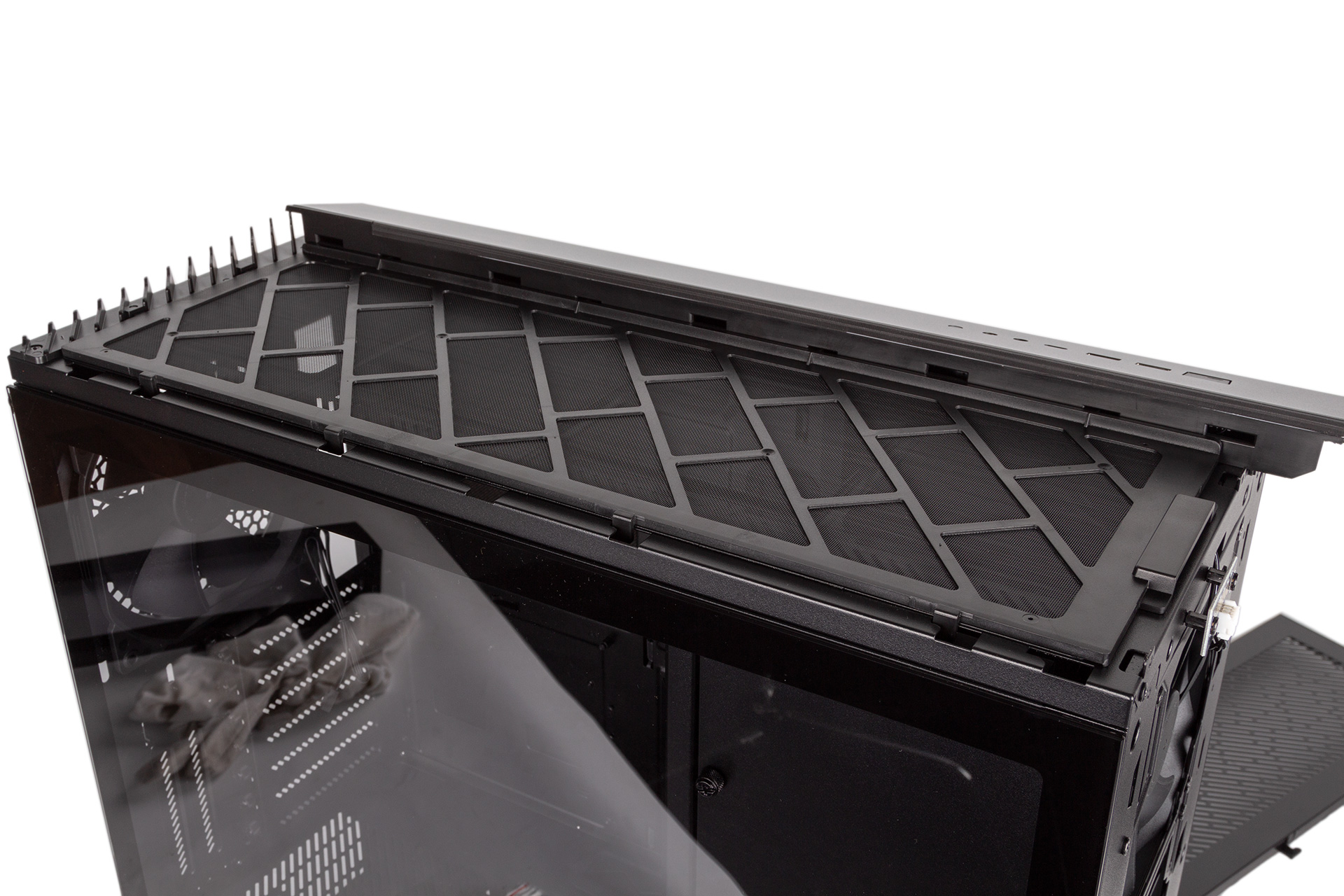

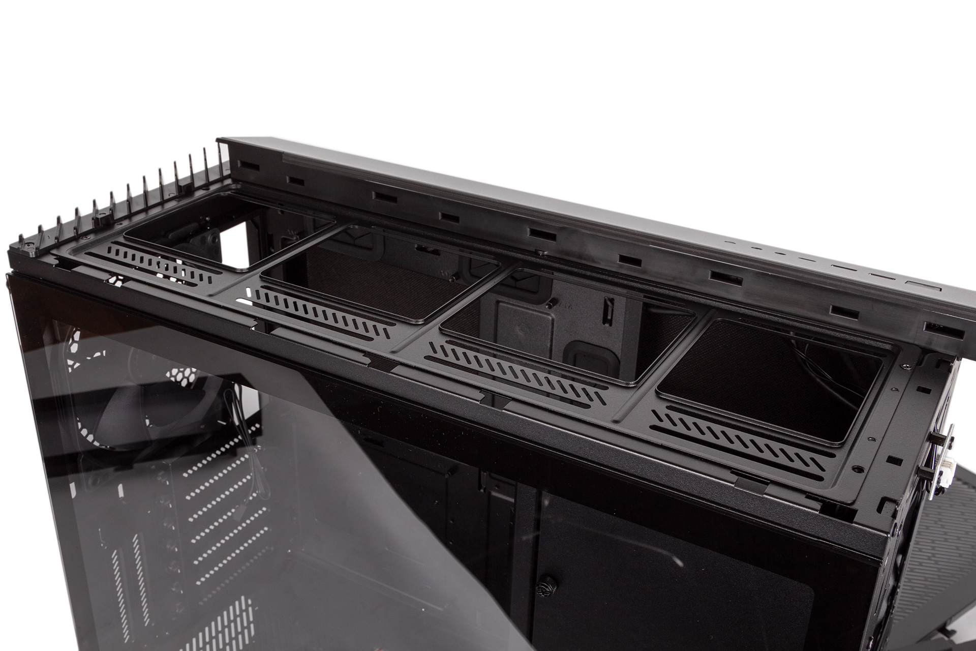

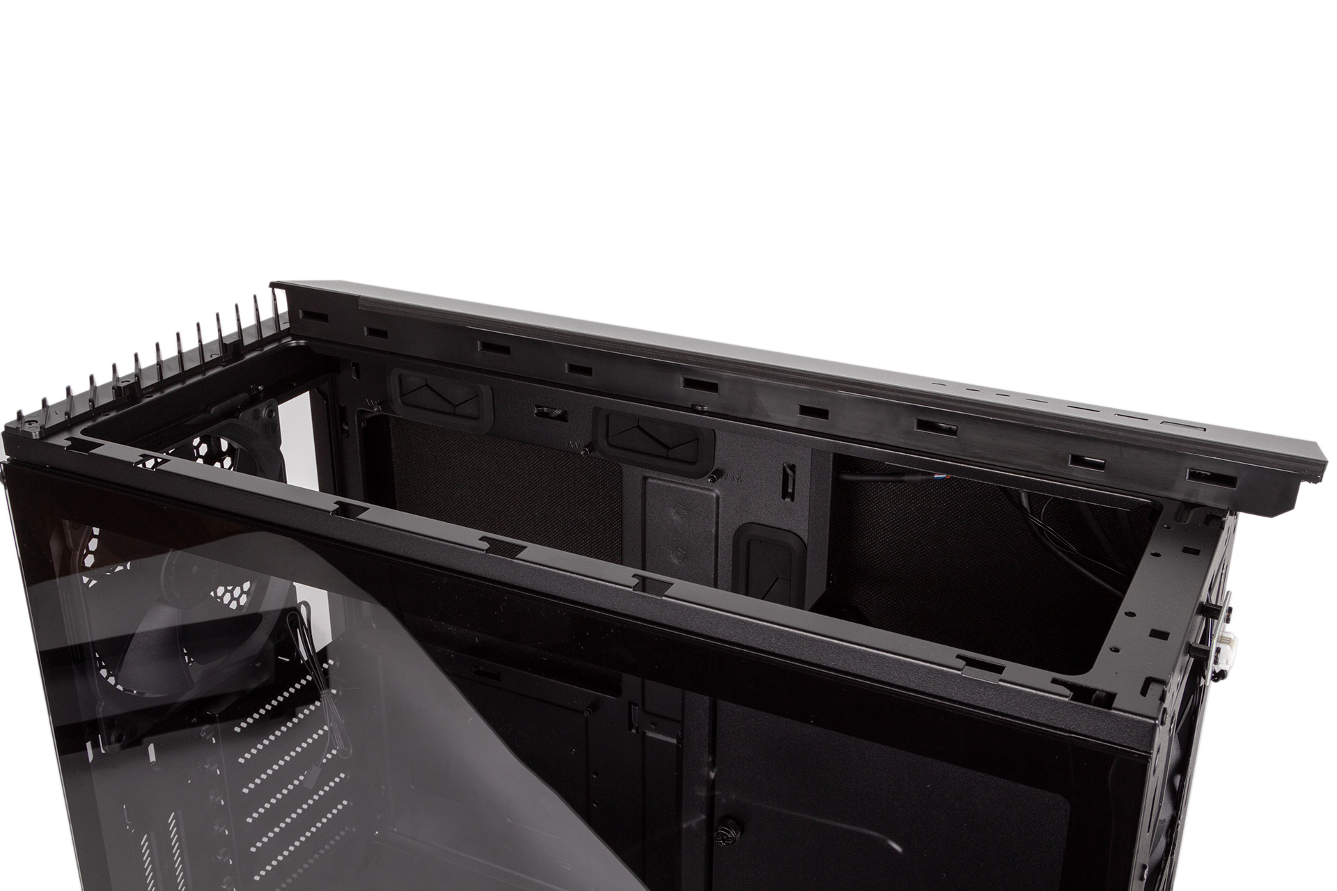

There is ample room to increase the number of fans in the case, with two 140mm/120mm mounts on the floor, up to three in the roof, and a third potential mounting location in the front as well. To maximise the use of the roof for this, you’ll need to swap the tempered glass cover out for a ventilated steel one, a three-part apparatus that includes a fan/radiator bracket, a dust filter, and a top cover. The swap is easy to make, and the structure remains nice and rigid once it’s complete.

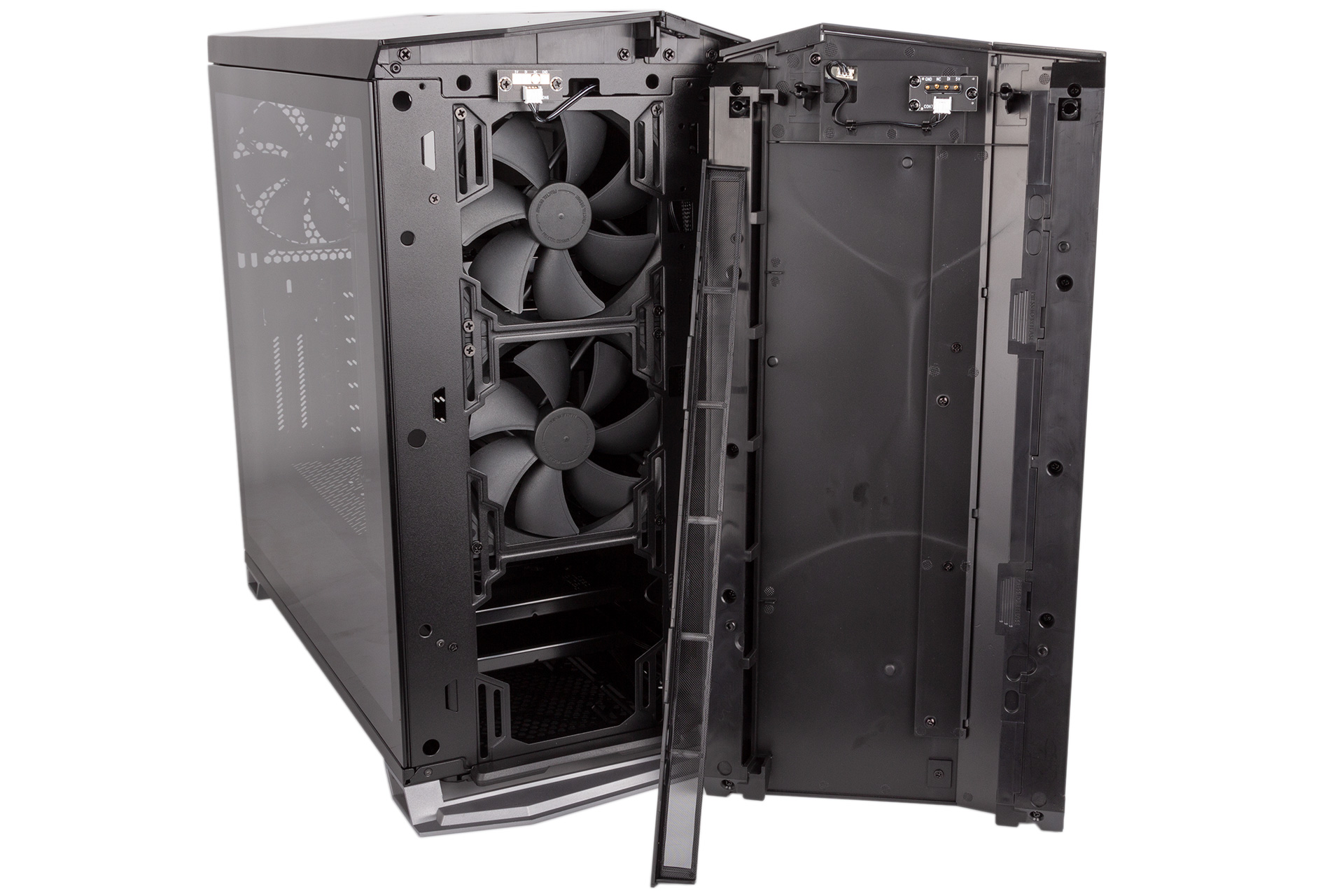

The front panel pulls off easily enough, and its weight is another indicator of the good build quality. It’s necessary to do this in order to swap the roof to the ventilated one, and you also need to do it to access the bottom dust filter, which is full-length and pulls out from the front. There are also removable filters built into the side vents of the front panel, so the Vector RS is fully shielded. Fractal also uses metal contacts instead of cables to connect the front and roof panels, allowing the LED strips to communicate without having wires getting in the way whenever you’re working with the case.
